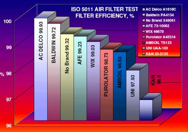

A commonly referenced filter test is the ISO 5011 test, that shows the AC Delco filter far superior to all other filters on the market and the K&N performing terribly.
But AC Delco doesn't make filters, they outsource all of their products. I suspect their filter is the same actual part as a Purolator, or Wix. Even if it's not, the ISO test shows a huge disparity even between paper filters - how could this be?
Purolator paper at 98.73% and the Delco at 99.93% - That means the Purolator is 18x less efficient than the Delco, passing 12.5x more dirt, with 50% less dirt holding capacity! None of the other paper filters even come close to the Delco. I don't buy it.
