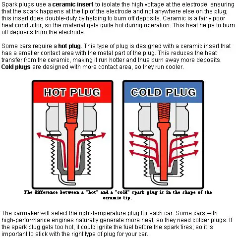

okay...im retarded. what do the heat ranges on plugs mean/do?

look at the last paragraph in that description. It means that too hot of a plug may cause detonation or pinging. While switching to a colder plug may stop detonation, the plug will foul up faster and the engine won't combust as efficiently unless in a high-performance application where overall temps are hotter.
Whoh... okay... im fouling plugs all the time and ping like a mad man when I visit my parents (I got uphill about 70mph). Would colder plugs help? I was using Bosh +4's and I have no idea whats in there now.... hmmm
nick
If the plugs are fouling, then you're either running too rich or the plugs are too cold already. I'd run the Motorcraft double plats at the recommended stock heat range for the year of the heads you have. If you ping, it's probably due to another problem.
