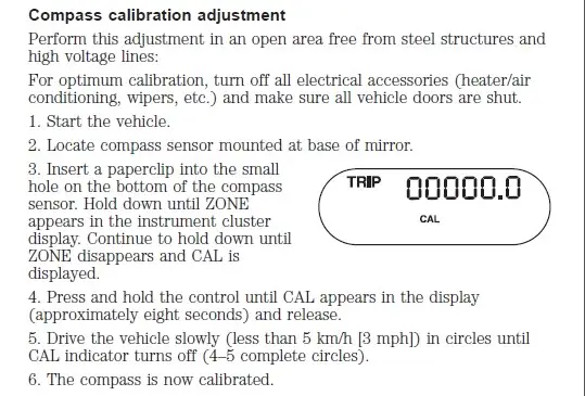

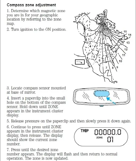

From my owner's manual:
Hope this helps out!! :biggthump
