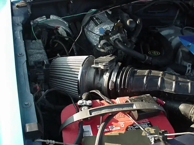

As some of you know I am still in the process of building my Explorer. If not, you can see pics of the front end in the Projects section.
The front end was built by me (tubing) to take up as little space as possible for maximum tire size with less lift.
This limits me as to where I can mount the air filter and MAS. In an ideal world, I could still run the stock air tube with the MAS hooked up to it and get the KKM kit or something similar.
But I don't have that option.
What I need to know is if anyone has hooked the MAS up to the throttle body via a short piece of rubber hose and then used the colincal filter right to the MAS? If so, where did you get what you used?
This would solve my problem. Thanks.
like this?
Check on RPS but there was a thread about this late last year, basically the MAS needs to be at least 10x the distance from the TB as the diameter of the intake tube, so if you are using a 3 inch intake tube it would need to be roughly 30" between the MAS and TB. This has something to do with a delay that occurs between when you step on the gas and the MAS responds to the increased airflow.
Tim
Ya, I'd say the minimum distance is 20-24", knowing about how the sensors output data.
I know that a lot of other ford vehicles are well under the 20"-24" rule so there is probably some type of calibration in the EEC depending on the type of vehicle. This may be correctable with a custom chip but I'm not sure how much they can change with those. Good Luck.
Tim
Originally posted by madmike
like this?
That is how I wanted to attach the filter to the MAS.
But I was hoping I could get away with mounting the MAS to the TB with a piece of 3" rubber tbing. Maybe not.
I'll figure something out.
Thanks!
