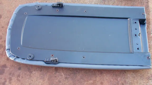

Like most, my Sport Trac's console lid had a hole worn through the vinyl. I bought a dark gray replacement kit off eBay from octane-usa. That's what their chart said was a match, but it isn't nearly as dark as the original dark graphite. Aside from that, the vinyl seems to be good quality, and it's cut plenty big. The instructions call for 1/4" staples, but all I had were 5/16" heavy duty staples that are much stouter than the staples Ford used. Next time I would use 1/4". The staples had to go into very hard plastic and the thinner staples might go in better. I used up a LOT of staples because they wouldn't go into the plastic. All the staples do is hold everything together until you can get the plastic panel screwed back onto the underside. The final result looks decent, but under that bottom cover, it's a mess! There are 3 screws for the hinge and 9 for the underside of the lid. I considered using my cordless drill to deal with that many screws. DON'T. The screws are all really short and come out/go back in with about 3 turns.

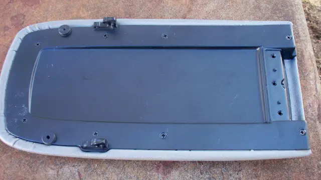

The lighter colored lid is an original medium gray lid from a '98 Explorer just for comparison.
