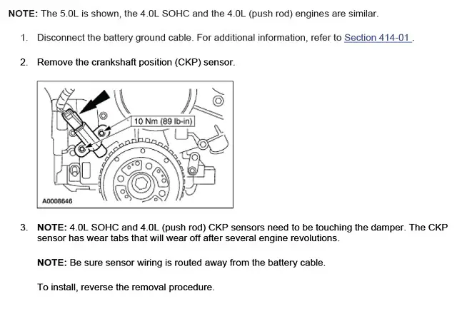

Is changing the crankshaft position sensor on a 97 Ex with a SOHC hard? Is it on the front or rear of engine? Passenger side or drivers? Any help is appreciated!
