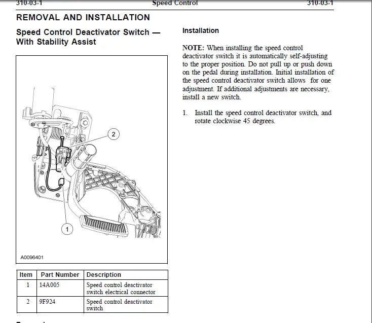

I start reading about it in the Service DVD (it refers to it as Speed Control, and can be very, very hard to find).
There apparently are two switches. One for RSC - equipped vehicles (its' under the dash at the brake pedal) and one for the rest (plugs into the top front end of the brake master cylinder).
What do you do if you have an 05 with RSC, cruise, cruise not working, and no switch in either position like the DVD says???
-Shawn
This what y'all are talking about?? I don't seem to have either....
Shawn
Edit. Mine is the top one. Both of those screengrabs came from the 05 service DVD, so apparently the difference is if you have RSC (Roll Stability Control).

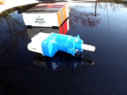

Don't confuse the switch that controls the brake lamps with the switch they sold me to replace:
This is a pic of the new switch:
And, here is the new and old switch:
Notice one is longer than the other? Recall above that the manual says you get one shot at installing this. If you muff up, you gotta throw the switch away and start over. What I noticed was two little white **** (I know, right??) that nest in the locking collar.
What happens is that this thing twists into place. As you do this, those little protrusions (for those of you offended by the word ****), twist also, releasing the switch rod, ensuring a correct clearance, kinda like how the rod pops out on a hydraulic clutch.
I also noticed that you can depress the rod, and twist the **** with a multitool, and it appears to reset, so, there's that for what its' worth.
