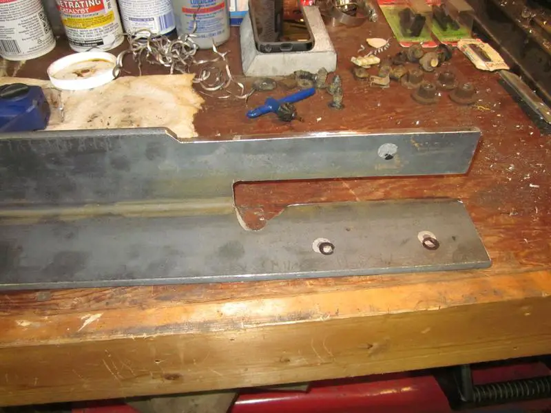

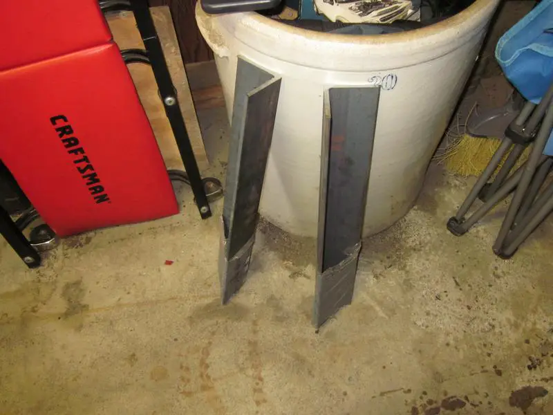

The stock I'm working from here is 1/4 angle steel with 3-inch legs. I picked up the stock from Fastenal, and it's ASTM A36.

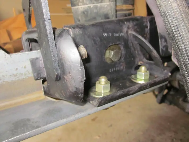

I then cut the steel to allow one leg (horizontal) to fit around the frame rail head and slide under the factory tow loop mounts, while the other leg (verticle) fits inside the frame rail and mounts to a stock hole just above the perch for the tow loops.
So that means each piece is mounted to the frame with two 1/2-inch grade 8 bolts on the horizontal leg, and a third 1/2-inch grade 8 bolt on the verticle leg.
Riight now, about a foot of the 2-foot sections of angle steel stick out beyond the frame. Once I fit the brush guard to these, I'll likely be able to trim the ends of these brackets back 6 inches or more. The guard will mount to the outside of each verticle leg, with about a 3/4 inch space between them (I'm using grade 8 bolts and sch 80 steel pipe to tie them together with the right space off). That means I could easily bolt a clevis mount under the horizontal leg, and might even be able to drill the verticle leg near the end to allow a D-ring to pin right through.

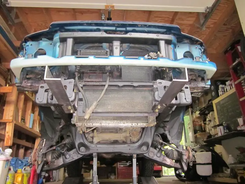

Here's how the brackets look bolted to the frame.
So, the question is, will the brackets be strong enough support a tow point? Keep in mind, the brush guard will connect the two brackets and reinforce them a bit against bending sideways, but I'd rather not count on the strength of a piece of metal designed to fend of saplings and scare Volvo drivers.
