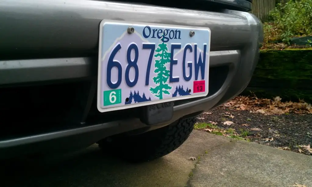

Well I finally got my front receiver, and installed it last week. I'd been wanting one to use for a front tow point. I chose the receiver over tow hooks because I didn't want to cut the bumper much, and in the future I can add a winch if I ever decide to get one.
As luck would have it it fits perfectly! I didn't have to trim one bit. I didn't get any pics of the installation, but basically I just took the bumper off, had to drill two holes in the frame, and bolt it right on.
As you can see it fits perfectly between the opening on the bumper, and if I ever need to use it I'll just pop the license plate off.
What brand and where did you buy it?
looks great, any picks of where its bolted to the frame? i plan to do this in the summer
I don't have any pics, but it bolts into the same holes that that black plastic radiator cover goes. I just got rid of mine. The holes closer to the front of the frame bolt right on, while the holes further back require drilling to enlarge them.
Just in time. Looking at picking one of these up.. Install sounds super easy also.
sounds pretty straight forward and my plastic is already removed as a result of my first major off road trip :rolleyes:
