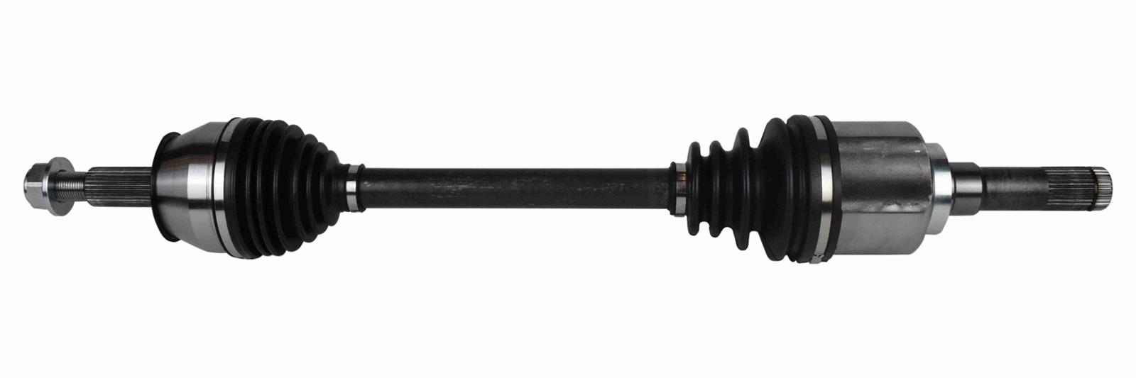

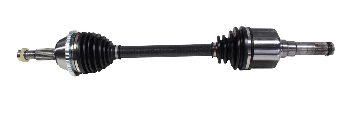

Hows it going everybody, hit a jump pretty hard in the ole explorer and bent a drivers rear cv axle. looking to replace on summit and get GSP brand but the problem is theres two part numbers with all different lengths. I'll link the part numbers below. does anybody know for a fact off the top of there heads?
thanks in advance.
Maybe this will help you decide which axle you need
Right rear cv axle
Length appears to change with build date. The door sticker on your truck will tell you your build date
Right rear cv axle
thanks! I always beat myself up for not using rock auto. I just hate how they never have updated there damn website. the site itself works no problem just man is it a eyesore.
Update : drivers left is 31.65
