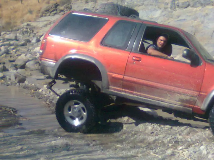

well finally started some mods on my X, SAS still standing by cant find a pitman arm long enough total lift of 9" on toy box, did a soa on the rear with custom shackles , changed the transfercase for a manual 1350 btw is there a SYE for this one , with the current setup cant handle enough flex :( ,maybe double cardan will help a bit, anyways ill leave u some pics.:exporange
Rear ends works great so far still have to get the drive shaft lenghtened.

Never seen a SYE for the 1350, I would try to find a manual 1354 they already have the fixed yokes
Every 1350 that I have had, or currently have, has been a fixed yoke, just not a "flange" style, simply the U-joint fitting directly to the yoke. As for the flex issue, that has never been a problem on the BIIs' or the Rangers. I have always had the double cardan style, though, on my trucks. Something to look into from the BII, if nothing else, simply to save some $$$ on a custom driveshaft.
BTW hmorris, is that a front bumper for a CJ/Wrongler that you are running on the "X"?
I thought the 1350 had that wierd front slip yoke, my buddys BII has one, its really bizzar looking and I heard there is a u-joint inside the case

yes thats a jeep bumper fitted good and doesnt look too bad. does it ? hehe
im working on a custom bumper as we speak also double shock mounts igot this 34" extended es9000 , will so how that works. Still need to fix leghts on the driveshafts.

Wow that's a lot of stress on those leaf springs with those shackles. Are you planning on adding some extra support to them?
ALready have. In that pic i only had one leaf the original one some how my x only came with one, but i just change it for a whole leaf package, really soft springs .next week ill take her out and test all the mods.
Usually second gen sports came with a monoleaf setup. Another brilliant idea from Ford. How much lift are you going for?
between 9"-11" I´ll measure it today.
On the 1350 Xcase; yeah, they do have a slip for the front with an internal Ujoint in the snout on the case. I get so used to people discussing the REAR driveshaft that I forget sometimes that the front can also be a slipjoint. I haven't had any issues with that end of the Xcase, but, then again, I haven't really tried to get the TTB to flex. Stupid "chicken wing" design.
well after the measuring it runed out with 9.5" of lift pretty decent height ,though tires look small now i run on 265/75 r16 I'll post some pics this weekend.
