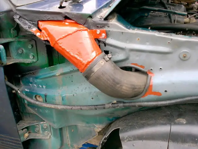

alright guys the factory intake placement strikes again

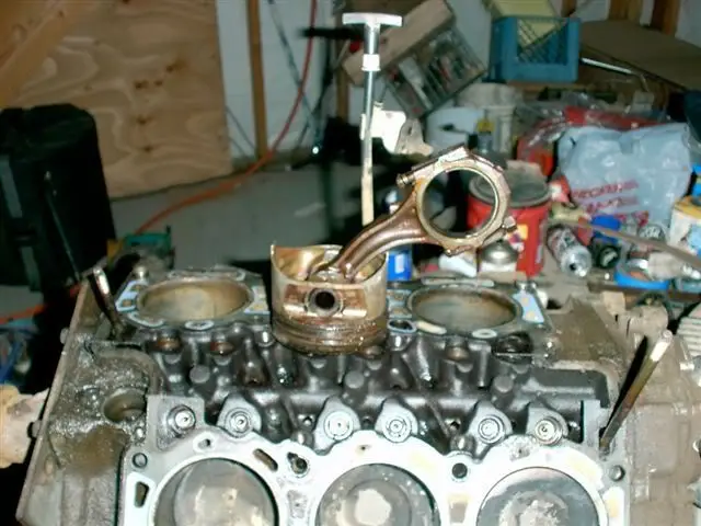

.went through some water about 2 and a half feet deep fast enough to make a bow wave that covered that awesome cold air duct and take in a gallon or so.#6 piston wedged against the counterweight and all the other rods bent to some degree
.i've been through deeper water but i guess fate cospired on this one.ohh well now i need to make a better air duct.who all out there with a first or second gen ranger or first gen X have built some thing to the cowl or a cool snorkle.is any thing available after market or been made to fit off a yota or something?
