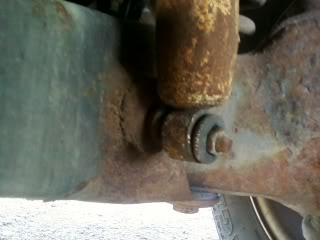

Also the alignment is off a bit. Can't really do anything about that until I fix the bad radius arm bracket and busted shock mount on the same radius arm. I tried the autozone kit, but the shock wants to slid off of the mount and there is not enough room to put a washer on it.

As for the shock issue, can you take a pic of the issue? I've used those shock bolts before and never had an issue with that. Worst, case, Radius arms are pretty cheap and Really worst case, I have 2 pairs of stock Radius arms in the scrap part pile in the back yard.

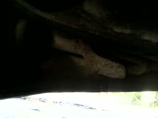

The only way I can snap a shot of it is with my cell phone right now. Will go do that now. Sorry if the images are a little dark, I done my best with my Samsung Intensity.
Passenger shock and bolt from outside.
From inside.

As for the radius arm. It came from a 91 explorer and the shock mount broke off in the middle of swapping mine with this one. My radius arm had a big chunk missing out because the last owner ran it with a busted radius arm bushing.
