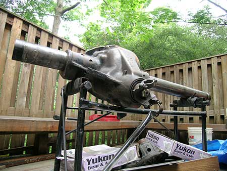

The Upper-Ball joint Sleeve on my Dana 44 front won't come out. They are rusted in and the castelated "prongs" at the top are pretty much eaten away by whoever tried to remove them before I bought the axle.
Sleeve:
Anyways, I have three options:
1) Since I already have the "C"s (or "inner knuckle") sliced from the axle tubes (to get proper pinion angle and caster), I could knock the "C"s out and replace them with another pair (ones with better ball joint sleeves). The problem with this option is that I would need to go to the junk yard and pull the replacement "C"s from the donor vehicle - which is not an easy job without power tools (grinder).
2) I could try taking a Dremel to the sleeve and slicing them out of the "C" - the problem is I might have to redo/retap the threads on the "C" because they look pretty rusted and dead.
3) I could just leave the old sleeves in and hope for the best.
What do you guys think? Is it required to replace the sleeve when replacing the upper ball joint? I'll probably try option 2 over the weekend but I'm not too sure its going to work.
Oh and if anyone has a set of Dana 44 "C"s they're not using, I'll gladly take them off your hands :D
Torquing those sleeves is part of the BJ install process. I've heard, at least. :D
Yeah so I've heard too.. 40 ft/lbs.
GUH, I guess that means option 3 is out.

An option I wasnt going to mention (but I might as well) was shoving a bent rod (like an L shape - with the same diameter as the sleeve's I.D.) up the center of the sleeve and then carefully welding this bent rod to the sleeve - and then turning the rod hoping the sleeve will go with it. I might give this a try over the weekend before the slicing the sleeve idea.
EDIT: I just remembered that the sleeve has a notch in it. So maybe I can make the same protrusion in that L-shaped rod I mentioned above to kind of act as a "key" - like how some motor shafts interface with gears .

Thanks for the link KirbyN. I'm going to first try to drive the sleeves out tomorrow.
They are soaking in lube right now and tomorrow, I'm going to shove the old-ball joint's shaft (the rod part with the thread at the end - I've cut the "cup" part of the ball joint), weld it to the sleeve, and try to rotate the two welded pieces together.
Well I've been defeated :o
I tried my approach of welding the shaft part of the ball joint to the sleeve but the weld broke after torqing it with about a 4.5 ft pipe extension.
So I admitted defeat and knocked out the "C"s
You can see how rotten the thread on the "C" was in the image below - so it probably is a good idea to get it replaced anyway.
Other than CRANE, does anyone else know of a company that sells new "C"s?
