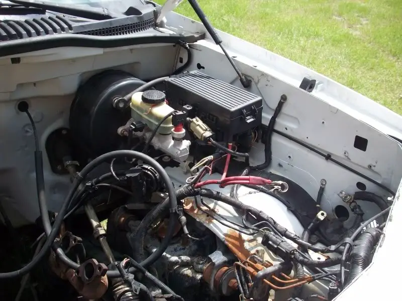

Here are some more pics guys.
Today was more of a lazy day, I just focused on cleaning up the engine bay and getting unnecessary things out.
Cleaning up good= purple power and clorox. It probably makes mustard gas but, I was wearing a mask and in a very ventilated area.
Engine bay looks nice and clean :thumbsup: I see you decided not to remove the headers with the engine? Easier just to remove the engine by unbolting the headers from the block or what?
I feel like I need to yank my engine out now just so I can clean!!
It was a lot easier to unbolt them from the engine. Then get a cheater bar to get them pulled away from the block a little bit. Once the clear the exhaust bolts you wont hear a peep out of them anymore.
The reason for all this is they will hit on the motor mounts/steering shaft on the way out from what we could see.
Alright...Good to know so if I change out my block to a 4.6 I'll know a better way to take the headers off the block. :thumbsup:
