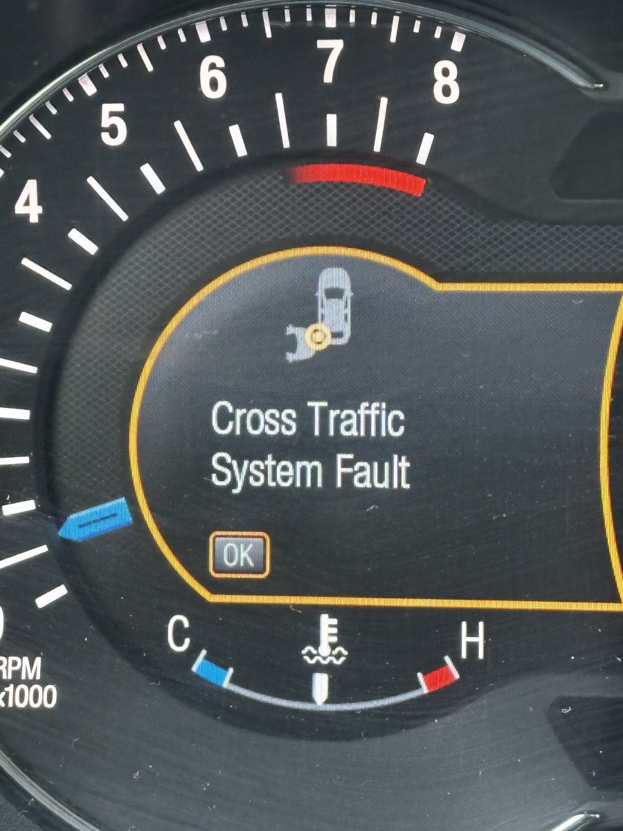

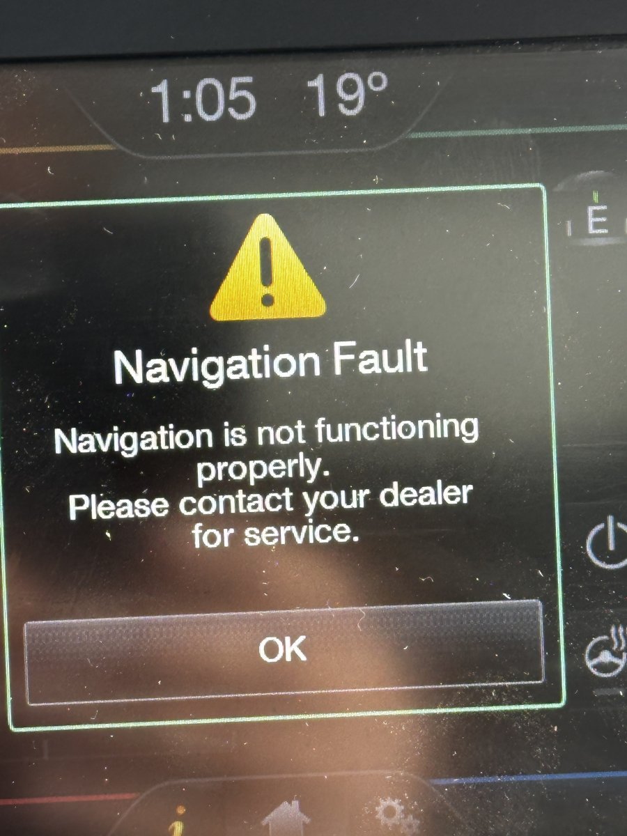

Just purchased a 2016 Ford Explorer Platinum in Alaska for a work vehicle when I come up here to fly. Bought it from Kendall Ford in Anchorage and got a 6 month warranty with my purchase. I purchased it on Dec 13, 2023 drove it for 3 days and then flew back home to the lower 48. Came back the 1st on January 2024 and the climate control panel operation became intermittent, got Navigation Fault, Cross Traffic System Fault. Took it to their dealership to get it fixed prior to my warranty running out. I was informed that my warranty didn’t cover the electrical system. So I was quoted $1300 to replace the APIM and troubleshooting. After looking on the internet, I figured I would just do the APIM upgrade to the SYNC 3 if I was going to spend that kinda of money. In the mean time I went to a local junkyard to bought a used APIM and installed it and the system was worse. Does anyone know if the aftermarket SYNC 3 APIM will fix my problems? I went to the local junkyard and got another APIM out of a wrecked explorer and had the same errors. Im thinking it might not be the APIM ?
