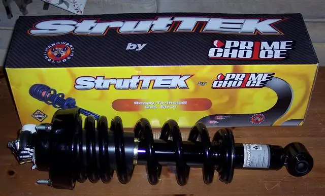

Got it installed, can't tell the difference from the original. Quality looks good too.
Took me the rest of the day to install both on my rears (taking my time doing some brake inspection too)
One thing that speeds up the process is that I didn't remove the tie rod from the knuckle (just the sway bar and lower arm to knuckle bolt), instead I remove the calipers and rotors (leaving the rotor is ok too) Both the struts slide in and out easily. Could be done faster if you have a buddy helping but it could be done by yourself.
