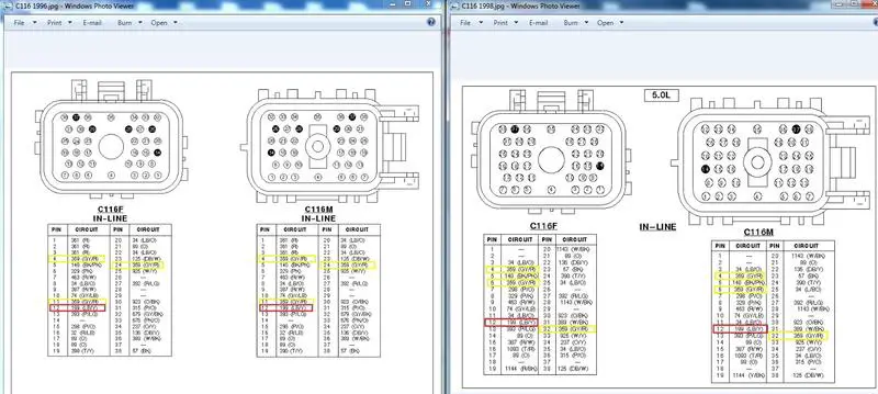

98 Explorer C116
Here is the 98, the last one was 97
Ground circuit
The ground circuit is different between the two connectors, circuit 359

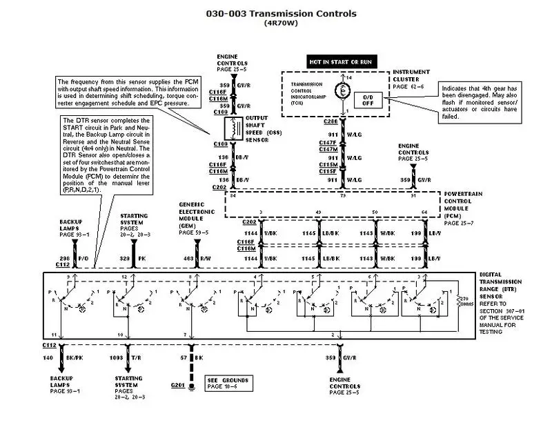

98 wiring diagram
98

It seems like the pins 64 and 91 were the circuits used, the transmission range selector is a stepped resister so it just changes a voltage going back to the PCM.

1996 and 1997 are the same at C116 for circuits 199 and 359(there are 3 of these)

Connector
Looking at the 1998 PCM and engine connector C116, and comparing it to the 1996 Trans connector C116
In theory you could repin the Trans connector side like this below.
Keep in mind it is only by looking at the circuit number and color, not all the wiring diagrams.
Use at your own risk.
Trans connector 1996
Move
11 to 6
6 to 8
8 to 11
Then move
24 to 32
wire in 32 goes no where? ( it would have gone to speed sensor on transmission?)
7 to 9
9 to 15
15 to 7
18 to 14
19 to 24
20 to 25
22 to 35
23 to 38
25 to 33
(What is in 33 goes nowhere tape it up)
31 to 36
35 to 22
36 to 31
38 to 23
