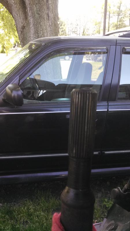

Just a few pics of my front shaft , I took it apart at the slip joint , popped the big end cap oil seal off , cut about half an inch off the female side and about three quarters of an inch off the splined end , reground the edges , repacked it with molly and all is well,

What did you cut the female side with?
I cut both sides with a cutoff wheel . And I figured someone would ask about vibration so I locked the hubs and took it for a ride , no vibration, so now I can focus on the cosmetics on the mounty and get back on the two door , I've got alot to do to get it where I want it
Ah ha!
You did exactly what I was wondering "what if?" and now we know!
I wasn't worried about balance since I have manual hubs and the front shaft will not be turning while on road, personally I think the AVM hub conversion should be done ( unless your goin sas) along with the 4406 , it makes as big a difference as the t-case itself,

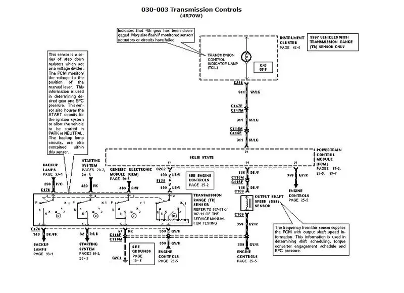

OK guys and gals I've been working on Vader again , he has been sitting forever and looks like crap but I need to get him back on the road , got the leak fixed , turned out to just be the pan gasket cause the pan was dented and warped , a few hours with some wood blocks and hammers and dollys and a straight edge all is good, now the only two things left I need to fix for inspection are an airbag code 52 and transmission range sensor circuit A high code , new range sensor installed properly and the plug is clean ,need help with what wire to look at , the airbag thing I've checked the fuses but not the connection at the module yet , any help would be appreciated

5.0 sport , late 97 with external egr and the 8 pin range sensor on the 4r70w , I am also having trouble finding the right diagram , I suspect a broken wire for the tranny
Fuses are all good and the proper size , that's what makes me think its a broken wire for the tranny , the airbag thing may be the module and I have one I can swap so for now I really need to figure out the TRS

One of the pinpoint tests, if I guessed the code correctly, says to check pin 6 at the TRS on the wire harness side when it is unplugged. Should be about 5 volts
Here is a wiring diagram

What was the trouble code number for the TRS?
I know you have a 5.0 now, what 4.0 was in there, sohc or ohv?
Po708 is the code and it was a SOHC
