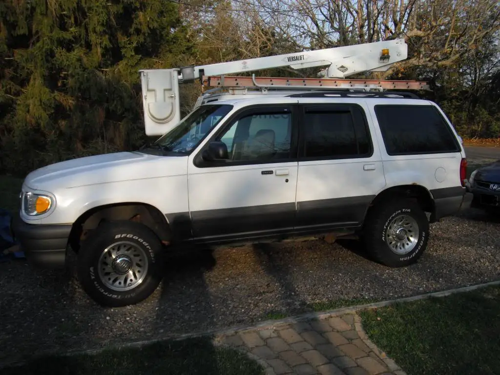

Sorry for the delay with the pics, I just finished working a double. Here she is, not as clean as yours. Ashamed to admit I haven't washed her since early winter. I think it's time for a little tlc.
Thanks for the pics. Twins indeed, we even have the same april inspection sticker haha.
