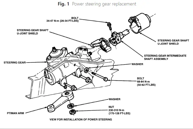

Thanks for the input fellas. I ran through those older threads ahead of this post but wanted some "eyes" on my specific movement. Can anyone point out the 'adjustment screw' in this diagram?

Be careful with adjustment however, if you have it too tightly adjusted it will wear out the steering box over time.

The adjustment screw is on the case of the steering box.
Tightening it will not actually remove slop, only add resistance to the movement.

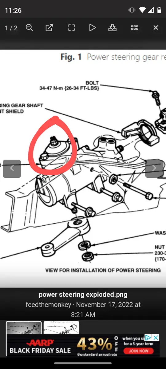

First check the center drag link. It'll have a ball joint on one end. Try to rotate the drag link. It should not budge. That done, on your steering gear opposite side of the shaft you'll notice a big nut and a theaded rod sticking out. Red circle on picture above. It'll either have a Allen head fitting or screwdriver fitting on the end. Loosen the nut. Turn the threaded rod clockwise until you feel resistance, don't over tighten it. With it adjusted hold the threaded rod part while you tighted the big nut down. What that does is takes the slack out of the worn worm gear and gives it extra life.
That adjuster on the box is for setting tension on the shaft, not taking up slack. Overtightening the adjuster will put more side pressure on worn parts, causing them to wear faster.
It's already wore out. I didn't say wrench it down. Turn it until you feel resistance and stop. Other than that buy a new one.
