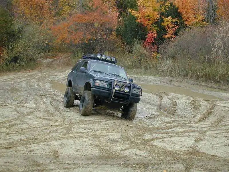

What is said by Ray and Lifted. It is the same. The mounts are permanent through 97. The superlift piggybacks. I have installed the superlift lift on a 95 and a 97 and there is no difference. Superlift doesn't know what they are talking about if you ask them they will tell you it won't work, but this proves otherwise:
