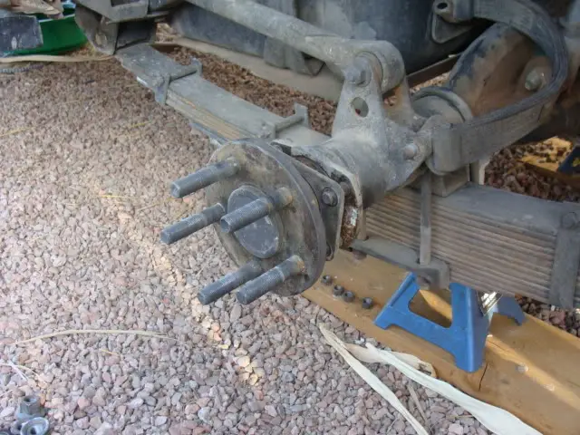

Anyway, lets start with a bare axle and some fun! This is a non c-clip style axle and it needs to come out for this install. There are 4 bolts that retain the axle shaft, so in this picture I have them loose.

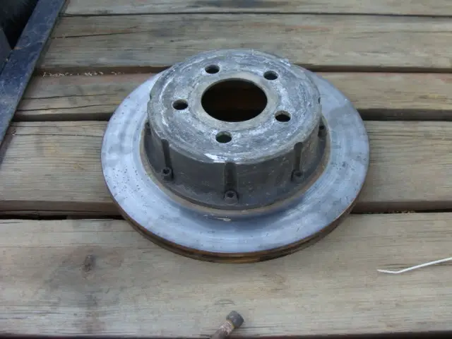

The rotor

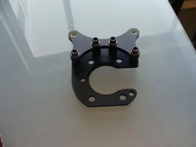

The bracket

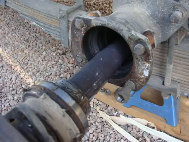

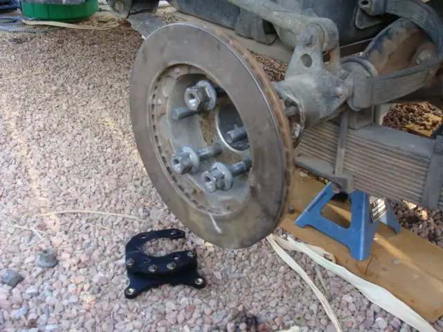

Okay, now you need to pull the axle shafts, easiest way to do this on the 9" is to flip your rotor around, put a few lugnuts on and use it like a slide hammer
Booya, it worked

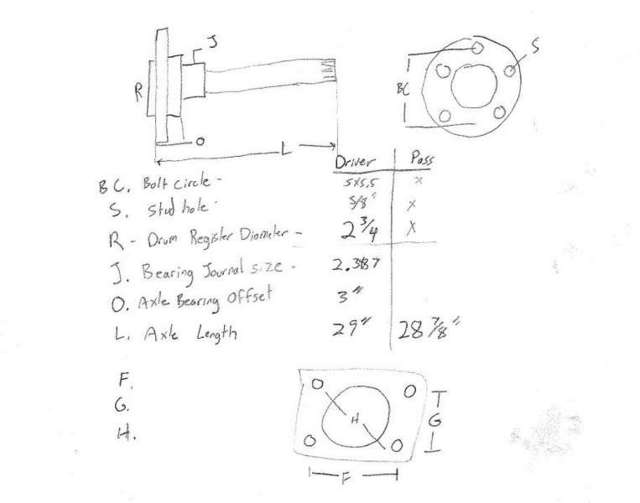

Okay, if you don't know the history of your axle, now is a great time to make yourself one of these and keep it on file. I find my photo gallery a great place to do this. (I think I found the original document on Currie's website)

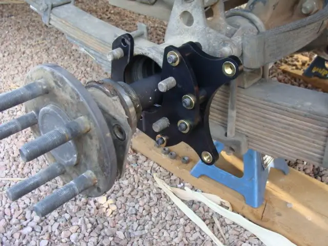

Put the bracket on then the shaft slides back into place.
Make sure it's looking like this picture so your rotor mounts in the right spot. There is a left and a right on this bracket.
Once the 4 bolts are tight it's easy to go from here. You can see I run a hard brake line right into the caliper. It was a pain at first for how often I was taking off the line but I've learned to suspend the caliper with a bungee when I take it off. Good thing about a 9" is that you rarely have any issues.
Then the 2 piece rotor slides right on and then you mount your caliper to the new bracket with 2 bolts, bleed them and be on your way.

The rotor
The bracket
Booya, it worked
