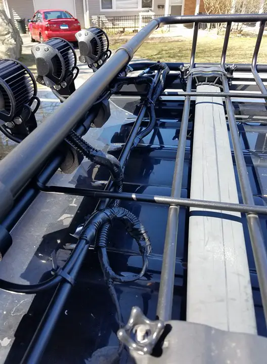

And here are the lights that'll be used on the rack. They are 18w x 4 = 72w / 12 = 6 amps. The wiring being rated for 80w meaning the wires are a perfect match.
