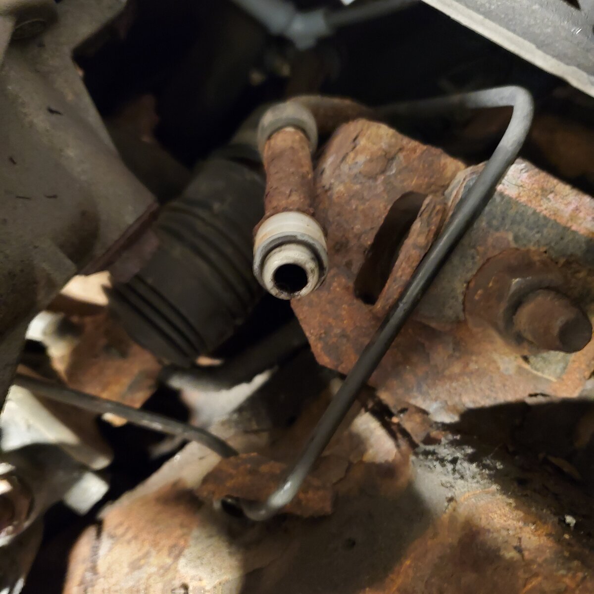

Thanks all for your help. I decided to ride the two horses that brought me this far due to the inherent risks. Small problem, I didn't take a picture of the coolant papa's hoses. Can anyone help me out?
Also two other items. I broke a clip off what appears to be a vacuem line. This is the mating item. Difficult for me to trace. Runs under left head, towards back of engine. The fitting appears to be integral to a formed line. Is there a fix for this?

Looks like EVAP. Check to verify (Should smell some fuel fumes. Goes to EVAP valve under battery.). If this went to EVAP, it is the tank side of the EVAP valve and you will have a code. Best guess would be to verify both ends and add a small piece of hose with clamps from one to the other. The EVAP line runs all the way to the back where the charcoal canisters are mounted above the spare tire.
The pictures are the bottom and top view of the EVAP lines at the valve.

thanks Chris. I sort of understand. the other end of 1 hose connects to a valve of some sort which is located under drivers wheelhouse. the other hose from this valve has two ends. one end plugs directly into the intake manifold (the clip broke removing, servicable?) another piece of the puzzle is a hose which connects directly into the intake manifold. Ive attached pictures. Does anyone source these lines other than Ford? One line is plastic tubing, the integral clip which holds the fitting on is broke. Can the fitting itself be serviced? There is a canister mounted on the passenger side wheelhouse in the engine bay. One of the lines to this has been broken for some time. how do i test the caonister? Finally there is a hose which is bad where the oil fill tube is located. The 3" dia rubber sleeve and the hose which has a connection at the end that plugs into air intake. what is that hose and are these parts sourceable(I dont know what to call them). thanks for your help!
EVAP Valve.
Try a fuel "duck bill" clip if the end is otherwise intact. If it does not work, salvage or splice.
Salvage, EBay?
Picture? Not tracking.
Salvage or splice.
