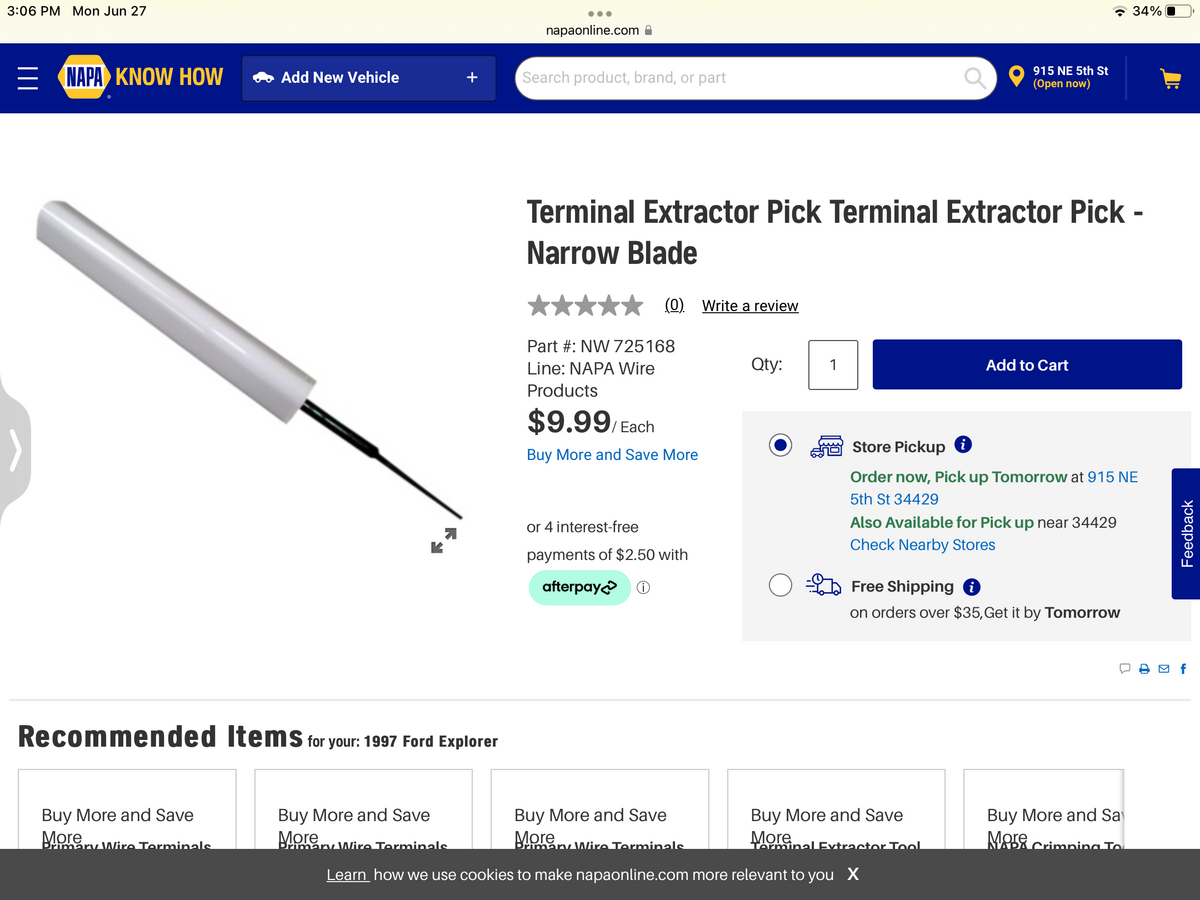

The NAPA “terminal extractor tool” looks like just about like a common pick ... I think.

I got one from a you pull wrecking yard and cut the wires that attached to the transfer case and took it to a mechanic that does work for me that is over my head. He showed me how to remove the wires. Mr. Alligator showed a pick and that is what he used. His pick was bent at an angle at the end. He used on the red insert and the tabs that hold the plugs in. It worked great. I have replaced my shift motor and my button shifts my explorer into 4wd again. Thanks for all the help.
