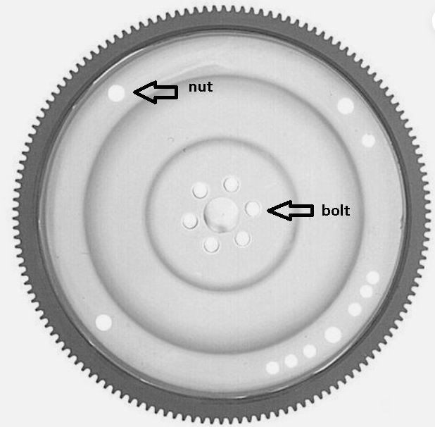

my mechanic informed me that there was a missing torque converter bolt from a previous repair
What TC bolt did he talking about?

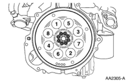

Your video sounds like the flex plate is comming loose. I had this similar sound miles later after transmission change,
cause i didn't tightened down the spacer bolts correctly.
Install the spacer, flywheel, and tighten the bolts in sequence in two steps:
(This is for the sohc, maybe the torque is similar)
1. Tighten to 13 Nm (10 lb-ft).
2. Tighten to 71 Nm (52 lb-ft).
Maybe the 4 torque converter nuts came loose, they should be self-locking.
But some nuts are not and should be loktited.
Unfortunately the tranny has to came out again to see whats going on.
Good luck and a Merry Christmas.
