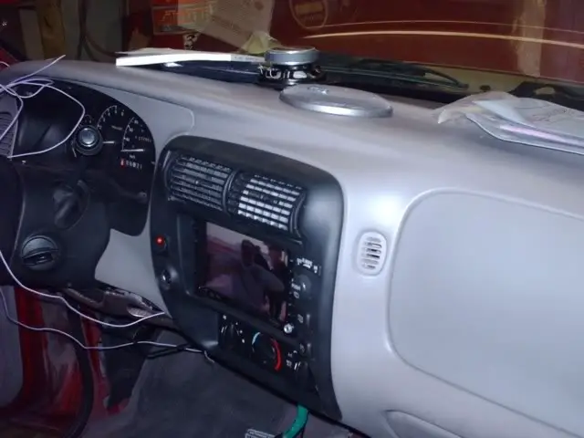

Besides - finding a good spot for a center channel on an Explorer is a huge challenge. Despite all of the reasons not to, I would try it if I could find a good place for the speaker in my '04.
