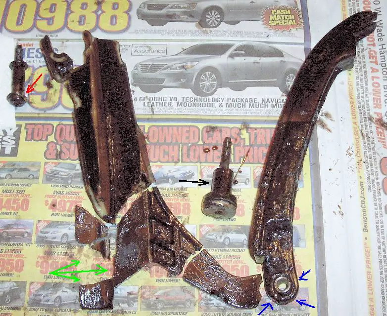

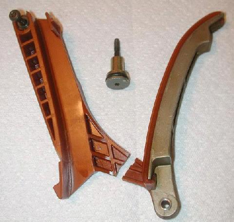

Recently there's been several threads about members purchasing a 3rd Generation Explorer with the 4.0L SOHC V6. I'm sorry if my advice offends any existing owners but I advise against purchasing one unless the original timing chain components have been replaced. Even though the timing chain cassettes were upgraded in the 2002 and later models the rear (right) cassette guide is still not reinforced with metal on the traction side.
That means that the guide is a candidate for failure after 200K miles and many earlier 3rd Gens are exceeding that mileage. Most potential sellers have determined this and that is why they are selling before catastrophe strikes.

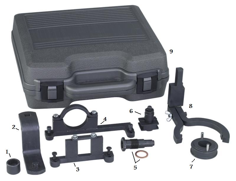

Replacing the rear cassette normally requires pulling the engine and accurately following a fairly sophisticated procedure. A special tool kit (OTC 6488) is normally required to retime the camshafts.

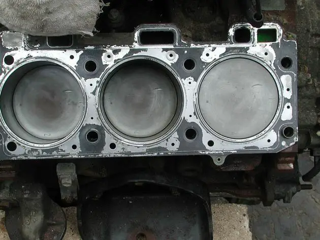

If the lower part of the cassette guide breaks then the chain could easily slip causing valve damage as shown below with the dings in the pistons when they collided with the valves.
