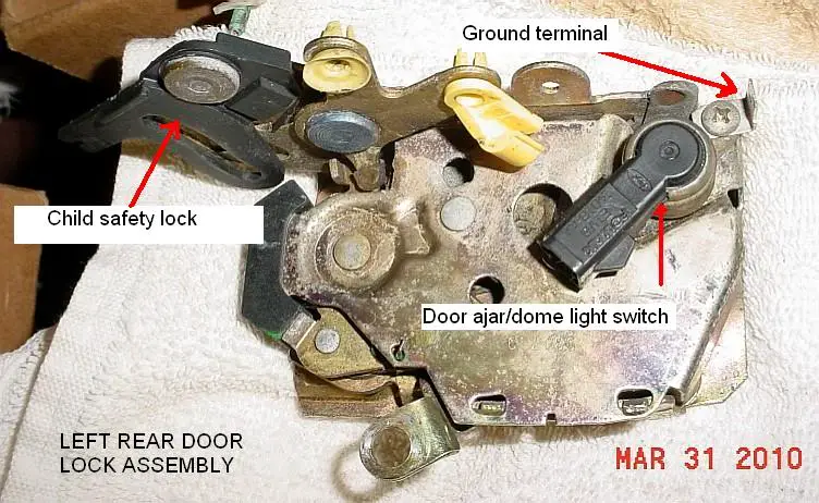

Here's your door latch showing the switch that sets off the adjar message and the dome lamp. You can see why you have to really soak it to clean and lubricate it from the outside. This is a rear latch but the fronts are very similar.
