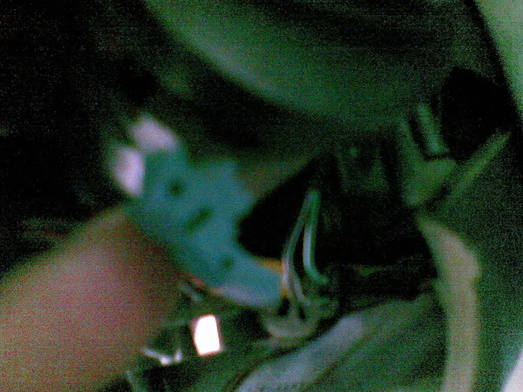

Mine does that too, here's the culprit:
This green thing senses if the key is in the ignition
Sorry for the super crappy cell pics
Thanks for the pics!! i tried the wd40 but it didnt work. so now on to the next thing that was posted with pics
