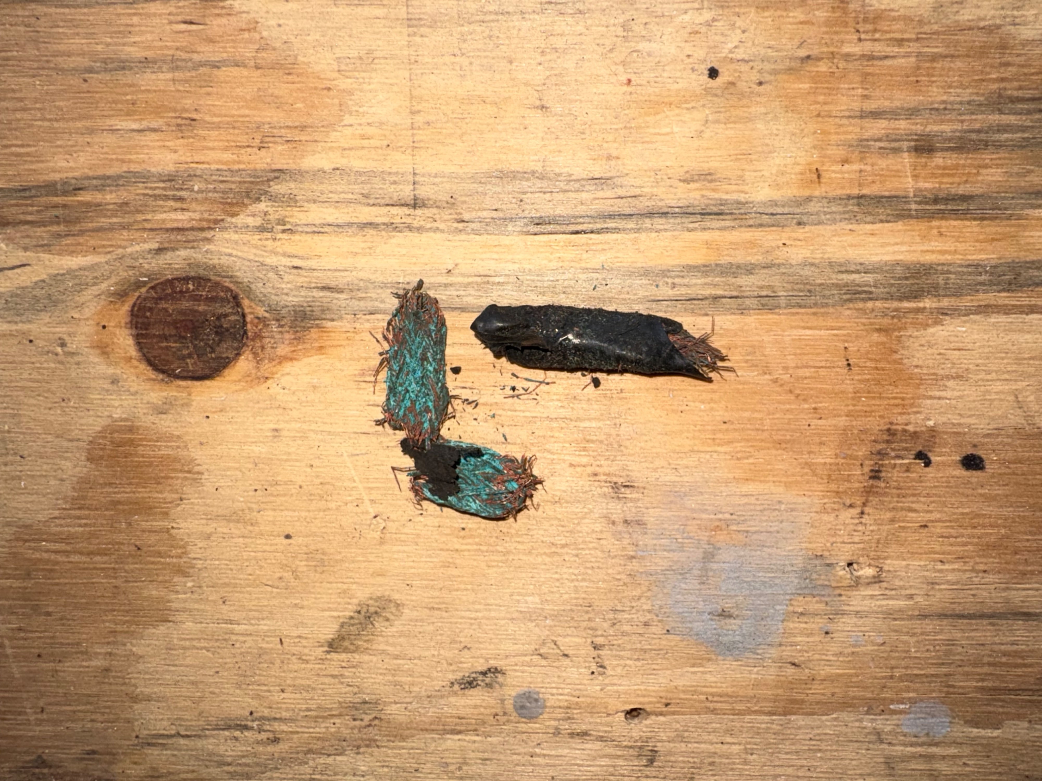

So, with the fob, I can unlock the doors but they will not lock. I removed the running boards a few days ago and noticed a green wire under the drivers door that is frayed and gone! It attaches to the frame in two places and appears to be a ground. I can’t find any other wires down there. It also blows out the fuse in slot 20 under the dash so I’m assuming that green wire is the reason. I can’t tap into it as there’s nothing there any longer. I have to unlock by hand now.

I replaced that ground and the locks now work! The windows, dash, radio, interior lights, headlights now don’t!

Found another ground strap on passenger side that was bad. Fixed that and windows now work. Still have no headlights!
