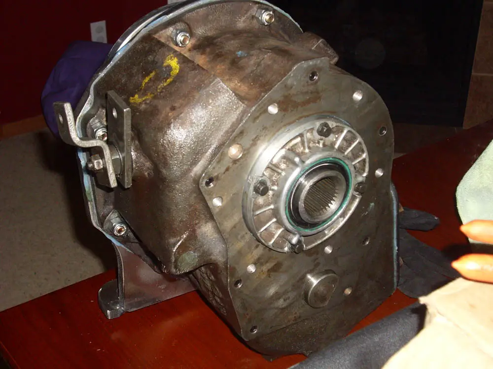

Center hole is the same for fullsize or RBV, 4.9". The RBV bolt pattern is actually wider than the fullsize. On the fullsize Ford the bolts are about 1" from the edge of the center hole, on the RBV the bolt holes are about 1.5" from the edge of the center hole. There is no room on a Ford 203 to drill and tap for the RBV trans. But from the pics I've found online a Chevy 203 for a TH350 trans or a Dodge 203 may work. I will have to find one that I can see in person to be sure.
ETA-I guess it doesn't have to be resplined to 23, it could be resplined to chevy. I think they used 27-spline, but IDK.

Found a pic of a dodge 203 redrilled to Ford round pattern. Looks like there is room for the RBV pattern. The 6 clean holes are the Ford pattern.
