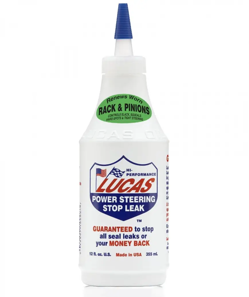

If you don’t have time to rebuild or replace the gearbox, try this product if you can find it in your country. I used it for years.
If you don’t have time to rebuild or replace the gearbox, try this product if you can find it in your country. I used it for years. View attachment 447727
Txs Ranger, I’ve found a liqui Molly equivalent. Seems a good product. I’ll keep in mind that. Thanks for the tip!!
hello Ranger x
The mechanic told me that he doesn’t have time to dismantle and repair in 24 hours
So I need to go with the stop leack solution for 10 days.
Any tip in how to apply? How do you do it?
I’m a little affraid but I’ll check the level and bring fluid with me to to up.
Sounds crazy but I don’t want to lower the arms just before the trip starts…..
You just add it to the power steering fluid reservoir, using it instead of the regular fluid. I kept the bottle in my truck and would add more whenever the level got low. It may not stop your leak 100%, but should slow it down at least, if your product is as good as the Lucas brand.
