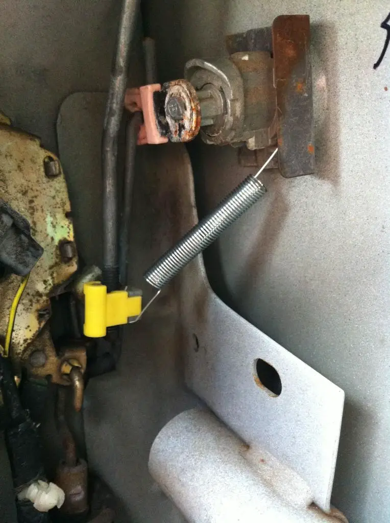

I've been putting off this problem for a while. The rivet that holds my lock actuator to the door broke and it has been held in by wire for a year or so, but the last 8 months or so, the actuator will not actually unlock the door. The only way to unlock it was by pulling the handle on the inside. Not even the key hole on the outside would unlock it.
Fast forward to today: I finally had some time to look at it. I tore everything apart and remounted the actuator to the door. Greased all moving parts with silicone spray lube and tested it. It worked! Then I closed the door and back to the same issue as before...
At this point the door will unlock/lock if open but not when it is closed. It's almost like the door jamb parts are too tight, but they seemed to move alright by hand. I'm at a loss. Oh and key hole still doesn't unlock it all the way almost like the rod between that and the jamb is too long.
