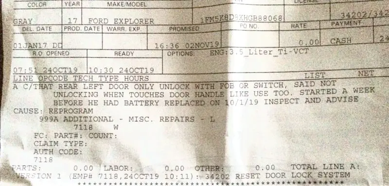

I had the same problem, the right side still worked like it was supposed to but not the drivers side. The dealership reprogramed it and it’s been working normally since.
By the way my battery had gone bad (bad cell) and the dealership replaced it the week before. They said it had nothing to do with the lock problem it was just a coincidence.
