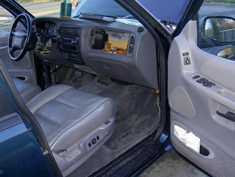

When I rewired my 99 Limited I used that circuit for my auxiliary circuits. I used my 93 Limited seats, and have the 99's as extra seats available. Good luck,
