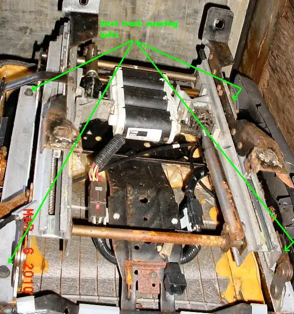

I would think you could put your manual seat tracks on the donor power seat. They simply bolt onto the seat frame.
