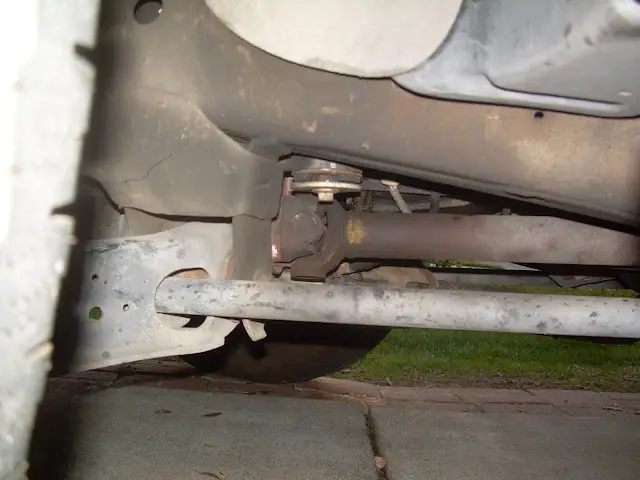

I couldn't see the instant of impact, but everytime it made the scrape sound the driveshaft would expose a part that had been scraped (picture to come.) I really can't figure out the why, though. It got dark, so he left before we could jack it up again to peak around, but I was wondering if anyone has a solution to make the scraping stop. My immediate thought was transmission mount messing with the pinion angle and doing something funky with the driveshaft, but I really don't know.

the driveshaft looks clean from the pic, did you check to see if it might of been the brakes?
the ujoints and CV (if a double cardon at the rear like the pic) on those front driveshafts do wear out. Just replaced mine at 155k. How many miles on the rig? Where's that pic?
Here's the rear of the double cardon...

I guess what we thought was scraping was just alignment marks from the factory? It looked more like a scratched mess than the normal blob I guess.
