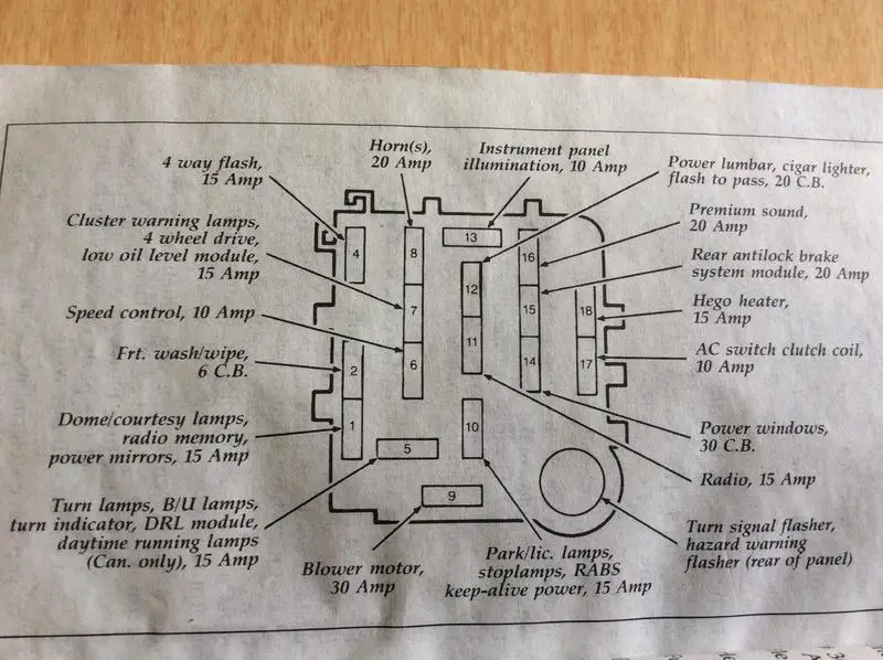

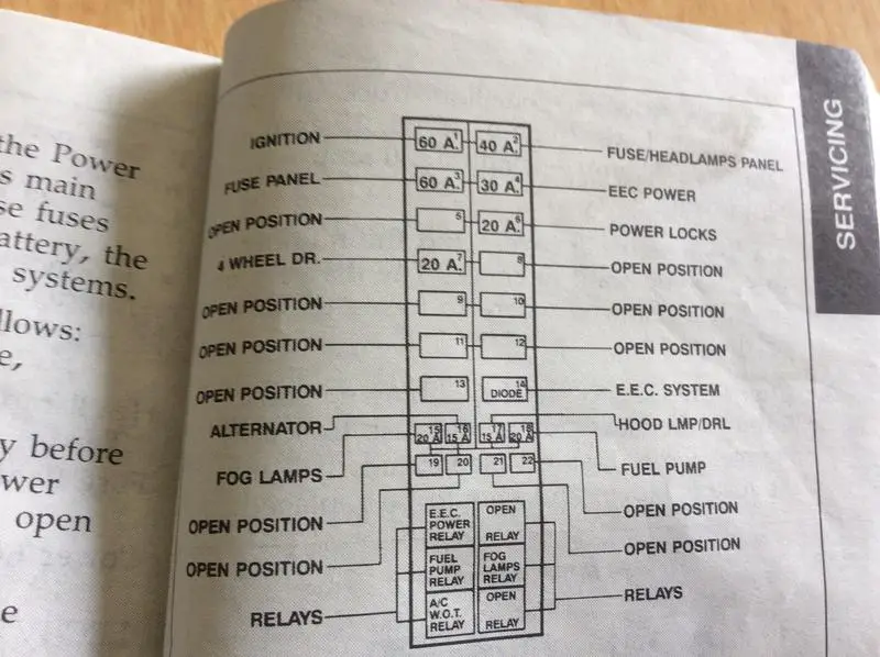

I have a 4wd 1994 4.0L ranger with and M5OD manual transmission.
Are there fuses for the transfer case, shift motor, transmission and such?
If so can anyone show me a fuse layout?
