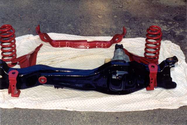

Note: 4x4 Explorers have 2 drive shafts whereas 2wd Explorers only have the rear shaft. If you look under your truck you should be able to identify the front and rear shafts as they connect to the center of the differentials. If you don't have a front shaft and front differential you don't have 4x4..
Here is a picture of the front TTB (Twin Traction Beam) of a 4x4 Explorer.. On the right side of the picture you can see the differential to which the front drive shaft would be connected.
