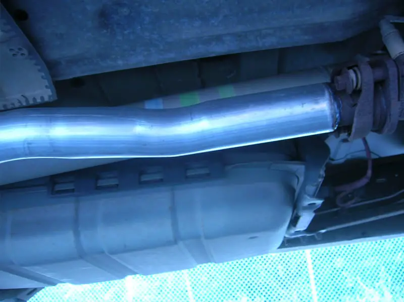

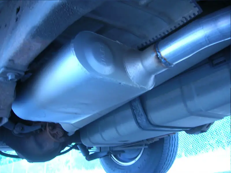

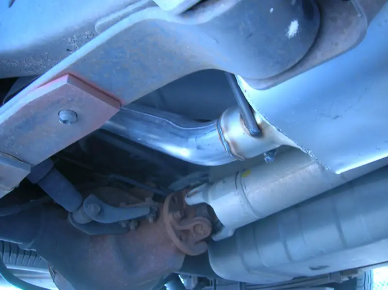

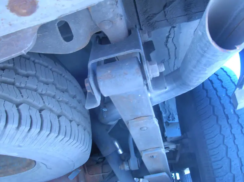

Update: Last week I went back to the shop and told them I wasn't satisfied with the sound. Luckily the manager was there and advised me to get a Flowmaster. After a few minutes of wondering if the guy might just be trying to squeeze more money out of me, I asked to see both mufflers. I was surprised at just how much more solid the Flowmaster was. You can definately tell that it was well built. I was just afraid it would be to loud. I went ahead and agreed, I also told him to add 2.25" tubing. He charged me the difference of the mufflers (50 bucks), the tubing and labor for the new tubing($50 also). Altogether I spent $200 and I'm very satisfied with the outcome. It sounds really aggressive when I start it up. The tone at idle is deep, and it sounds mean as hell when accelerating from stop lights. Most of the time when the speed levels out I can't even hear it unless I'm going under a bridge. The only drone I can hear seems to happen when cruising between 55-60 mph and I have to be listening for it. Unfortunately I don't have a camera that records sound so I can't get a clip for you guys, but here are some pictures I took yesterday.
By the way its a Flowmaster 40 Delta
