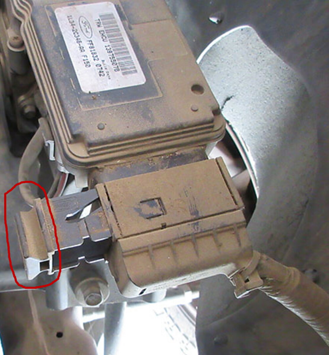

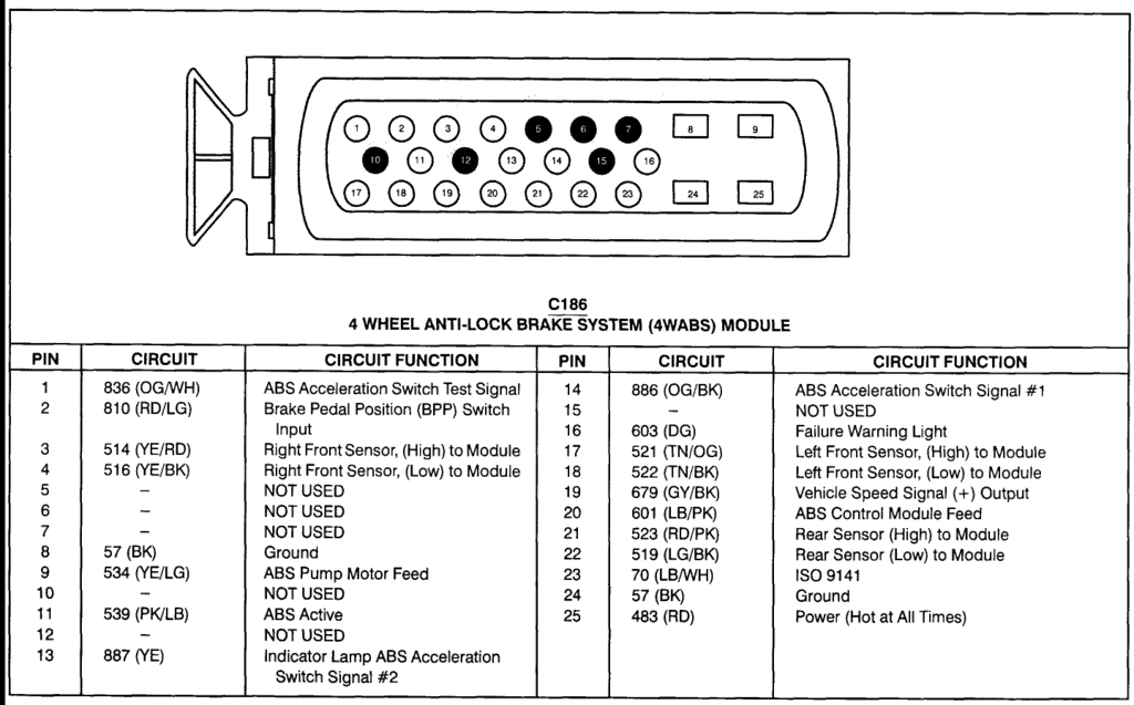

If you have a multimeter you can measure resistance of the sensor coil, should be about 420 ohms, can measure for low AC voltage at the ABS control module (under hood) when the wheel is spinning, and also can measure for same 420 ohms at the ABS control module connector (pictured below) to determine if the wiring and sensor circuit to the control module are continuous. 420 ohms is only approximate, could be off maybe 15%+ and still be fine.
Your ABS control module may be oriented differently than in this picture below but this is what it looks like and shows the connector interlock pulled out to disconnect it for testing.
