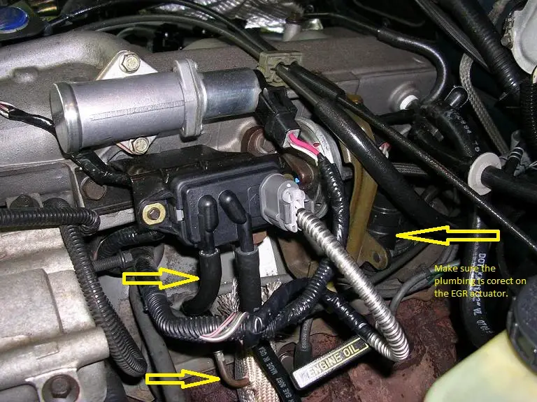

Sounds like very low throttle pre-detonation.
Double-tripple check your EGR vac lines. (proper routing)
A wide open EGR at idle will cause pinning at very low throttle.
In particular the DPFE:
The Lower/larger/longer hose on the rear port
The short smaller diameter on the front port.
And the EVR (EGR actuator)

And he does have the EGR system, you can see it in his video.
I hate to say it after all he's been through but I think he's gonna have to flash the PCM to get the EGR to cooperate with the higher compression heads. The exhaust manifold pressure differential is going to be different at least at idle. I'm hoping it will not be out of range of the DPFE to compensate.
Most likely though it'll just lope a bit at idle. Once he gets it sorted out.
