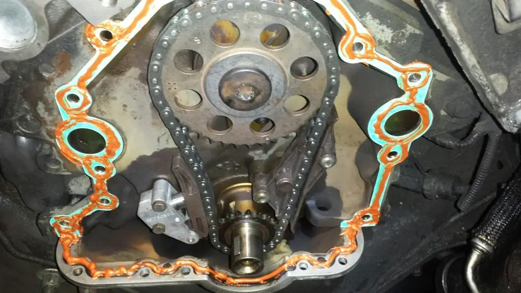

not sure where the cps would be heres my timing chain after replacement of the parts
Obviously they are not straight up and down but if the crank was it looks like they would be off.that not a poc of what was tdc and them aligned correct?? (Have to ask)
Cps(cam) is on the back of the engine. .
you can see the timing marks have just been turned slightly past alignment- but they rotate towards each other and were perfect right before i took out the crank bolt that i had re threaded to help get everything set
Idk the cam looks to be one tooth off to me.any other pics??
Yea there is no way those are aligned if they are just slightly turned.if you turn the crank counter clockwise to bring the lower dot on the crank to the 12:00 position it would spin the cam counterclockwise moving the dot towards more of the 3:00 position.even after you spin it counterclockwise you would need to spin it past 12:00 (crank) then back to 12:00 to take the tension out..
Or wait I need to view this on a real screen.because I just remembered I think the dot is above the key on the crank..what looks to be a dot on my phone is not above the key in this pic...may disregard what I just said.....ill look later at home..
when i was preparing to take out the timing chain gear i rotated the marks to be in line with each other while i locked the crank into position. both the crcank and the cam have tabs so the crank pulley and the timing gear cant go on any defferently.
am i wrong in assuming that as long as the crank was locked while i took the timing chain off and replaced the gear that it wouldnt matter when i put the new one on?
neither the cam nor crank moved while i took the chain off. also, it idles nicely and really smooth in park and neutral. would the sputtering in driver and reverse be the result of a mistimed engine?
Just depends. .what I can see on my phone plus the drinks I have may not be the mark.I swear the dot was above the key..

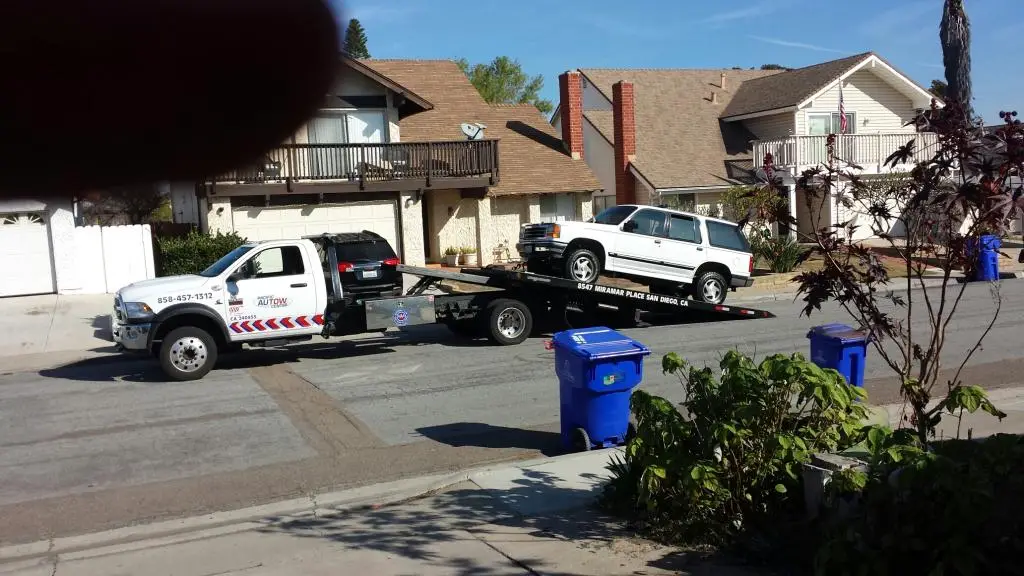

well as of 30 mins ago i had it towed to the dealership. i didnt tell them that the heads are from a 98 or that i had canged the timing chain stuff, but i did tell them about all the stuff i replaced stock. of course as soon as the ex gets loaded, the lower radiator hose starts to leak.... it was too late for me to tighten the screw on the band before the guy drove away. hopefully the dealer remembers to tighten and top off before they come to me with anything lol
