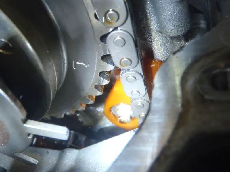

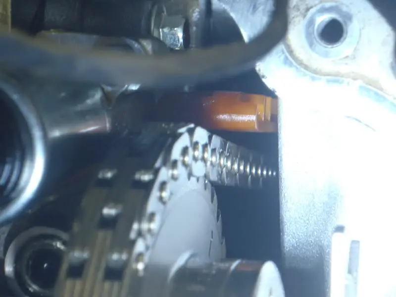

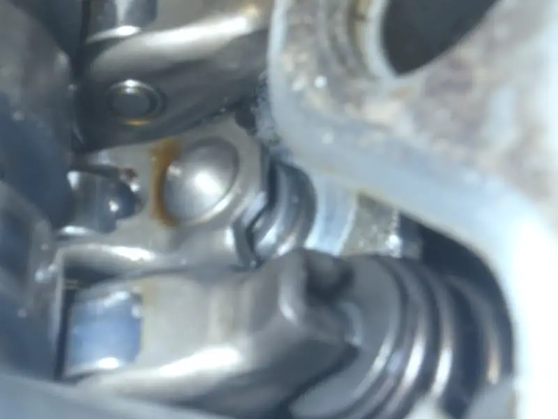

I'm trying to diagnose an engine noise. my stethoscope pinpointed it to the passenger side bank of the valve train towards the front of the engine. If the stethoscope was pointed on a valve cover bolt the noise would be ear shattering loud. You can only hear the nose at a stop revved up between 750-1000 rpm or a no load rpm before torque converter lockup. When there is any slight load on the engine the noise goes away.
I didn't see any obvious signs of valve train failure. I don't have much experience with fords so I'm wondering if any one see's some thing out of the norm with these photos.
The timing chain tensioner is keeping tension on the chain but I do see slack between the top chain guide, maybe the noise I'm hearing is the chain slapping against the guide? The noise did sound more metallic so I'm not sure if this is the case.
I saw some scoring on the timing chain sprocket.
Lifter slightly collapsed?
Sounds like normal cam phaser operation. Do a google search , and a forum search. There are even you tube videos about it. Ford has tsb about it.
Great thanks, looks like alldata has failed me again. The only TSB they have is regarding a ticking noise due to a stuck lash adjuster.
google" ssm 21217 " thats the ford special service message regarding vct ticking
Thanks, its very interesting reading about this issue. It's amazing that the internal impact making this noise hasn't caused major damage over time and is considered normal. I wish I found this info before taking the valve cover off but its better being on the safe side.
