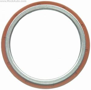

The photo below shows two FelPro seals listed on RockAuto for my SOHC engine. They don't appear to be equivalent.
The first one looks like
FEL-PRO BS40647 Rear Main Seal Set, Rear; Type: Rear Main Seal Set; PTFE Rubber; One-piece
The second one looks like
FEL-PRO BS40619 {#5TZ6701A} Rear Main Seal Set, Rear; Type: Rear Main Seal Set; Wear sleeve incl; Rubber; One-piece
I guess the BS40647 is the seal without a wear sleeve? Odd though, it's more expensive than the one with the wear sleeve.
I have the BS40619 ready for installation, it has the wear sleeve included.
Rockauto also has Mahle JV1618 which looks the same and description says "Wear Sleeve Included"
Original Ford part number for seal with wear sleeve is 5TZ-6701-A, about $50 from one of the online Ford part websites. Versus $8-$16 for Mahle or Fel-Pro.
@StreetRod, is that Fel-Pro seal you installed still holding up ok?
The PTFE rubber is more expensive to manufacture. I suspect it lasts longer than the normal rubber but I avoided it because it is harder and more likely to leak on a worn crankshaft. I did not install the sleeve. As far as I know my seal is not leaking. However, I wished that I had replaced the valve cover gaskets or used a sealant when I reused the ones on the engine. I had a leak on the driver side initially and had to keep tightening the bolts to stop it.
