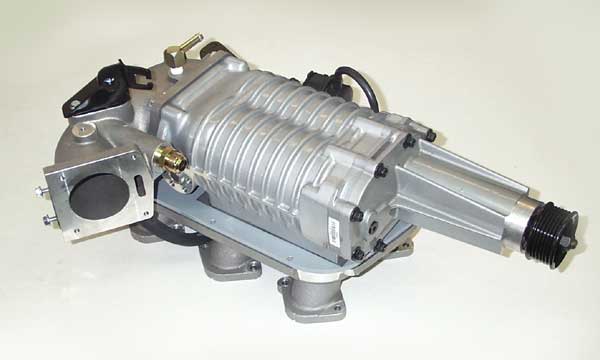

We are getting very close on our Eaton based supercharger kit for the V6 SOHC. We are still developing the kit for the 97-00 Explorers. We have several vehicles with the kit installed including , 2 Rangers, 2 Sport Tracs & 2 02 Explorers.
not all 5.0 x's are awd- just thought it was worth doing that along with it. some are 2wd.
that system looks great, i wish i could give up that much cargo room. i'm working on my install now and its rough trying to leave room for golf clubs and stuff. i bet that sounds great, and those x.. will definitely destroy that stuff you have now. That will be very, very loud- how do you plan on getting enough current for 3 of those amps though? sounds like time for extra alternators
Our kit uses an Eaton M62 fourth generation model manufactured for us by Magnuson Products. This kit is design to use all of the factory smog equipment including EGR etc. We have started the CARB approval process for states that require emissions approval.

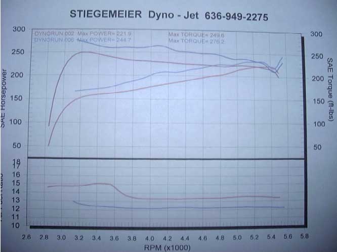

This is not a tease bud. We have three vehicles in the SEMA show that will feature the X-Charger. Sport Truck magazine is doing an installation article on the supercharger. Joe Pettitt from Primedia was on hand to cover the project, very cool guy.
A recent dyno run on a Sport Trac by Brian from Apten in St.Louis pulled 221.9 RWHP & 249.6 TORQUE. After Brian worked his tuning magic he managed 244.7 RWHP & 276.2 rear wheel torque! He will be supplying the special chip for our kit.

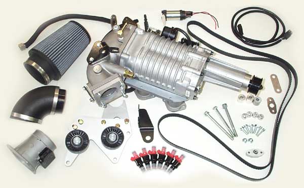

Here is a picture of the complete kit. It will include a fuel injector upgrade (30lb), high pressure fuel pump and Pro-M 80mm Mass Air Sensor. It will also include everything required for the installation.
By the way, the speaker system in the photo is awesome! Around here we focus on MORE POWER!
