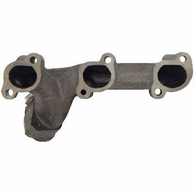

I knew the difference in the heads is the exhaust port and the heads I bought have the larger 1.7" exhaust ports but if you look at the exhaust manifolds you will see they block a part of the exhaust port in the head...This is the difference in the manifolds between 97 and 99...
The pair of new heads complete from J & C was $335 without a core charge...Currently I am running these heads with the 99 manifolds but that will change later this week when I install 97 manifolds and open up the exhaust a bit... Actually the 97 exhaust manifolds flow at least 19% better than my 99 manifolds...And with over 160k on the original catalytic convertors I am replacing them as well...
After driving the truck with the new engine, I feel a restriction is in the exhaust... Whether the outlet side of the convertors are cooler than the inlet or the manifolds are restricting flow by design I plan on removing the restrictions and keeping the flow path the same size as stock but I do plan on running duals from the flange with the 2 pipes through a pair of hiflow cats to a dual in/dual out Magnaflow stainless muffler...
