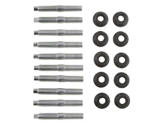

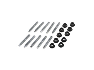

Thought I'd throw this out there, since no company lists replacement studs specifically for our 4.0L (and to remind me when I need them again).
Dorman 03411, which are only marketed for Ford 4.6L/5.4L/6.8L, are exact replacements for our 4.0L.
Pairs well with Permatex Nickel Anti-Seize.
Is “our 4.0L” the SOHC or the OHV? Or is there no difference in the manifold studs?
I used them on my sohc installation

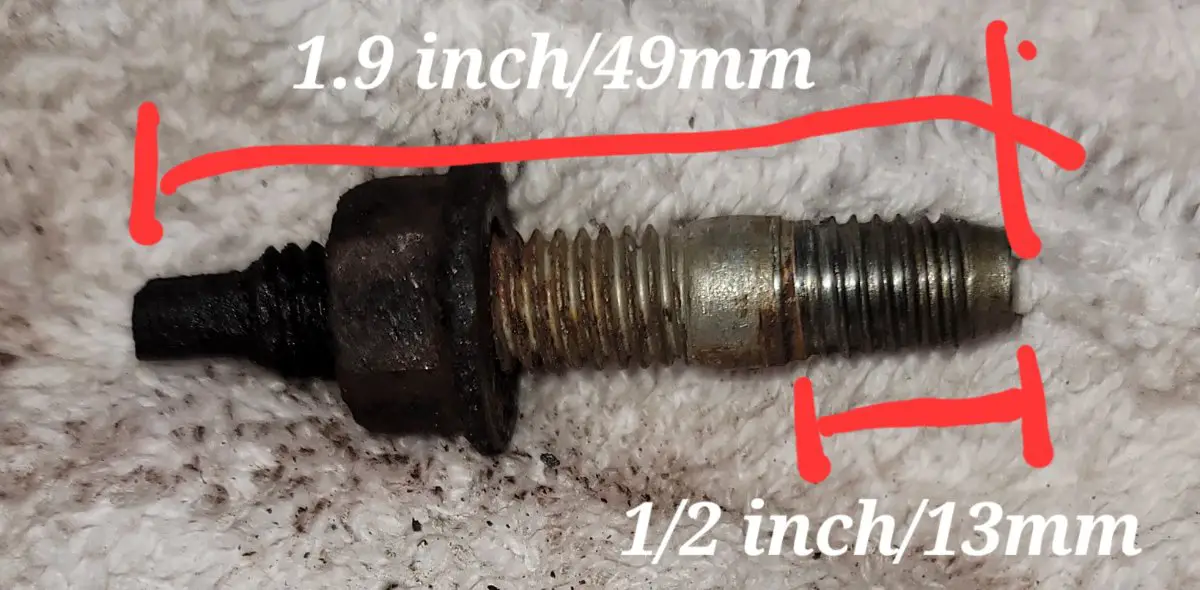

Resurrecting this older thread...
Does anyone know if the OHV 4.0l use the same exhaust manifold studs as the SOHC?
My studs are:
M8 1.25
1.9 inches/49mm
The side that screws into the head is 1/2 inch/13 mm.
The shallowest hole on the head is .65 inch/16.45mm.
None of the exhaust manifold bolts I find on Amazon list the lengths.
Any suggestions?
